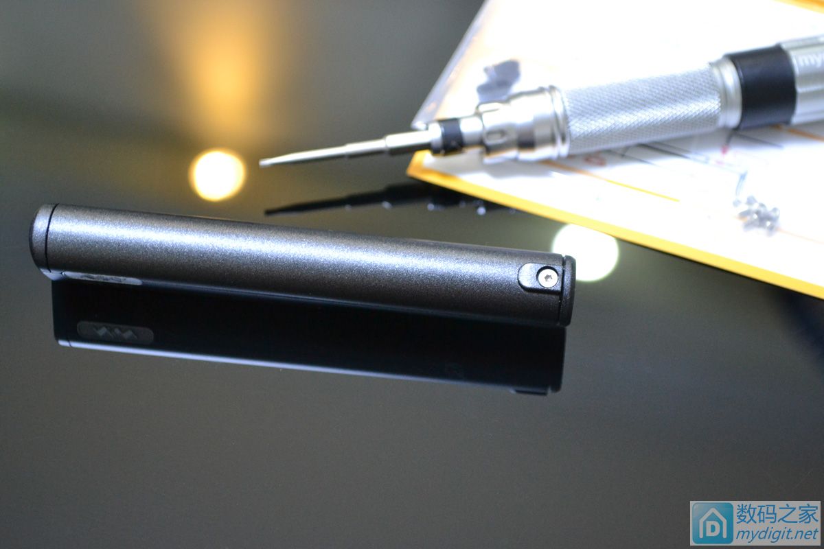

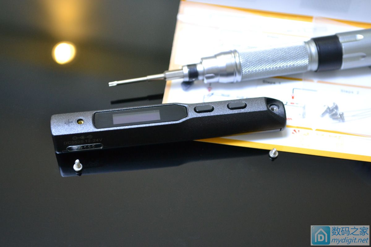

First remove the two screws on the front
Remove one screw on the back

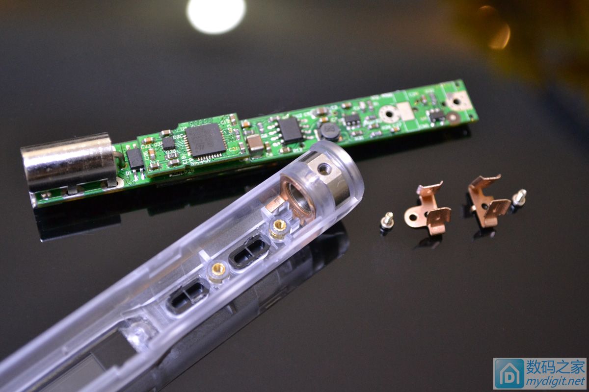

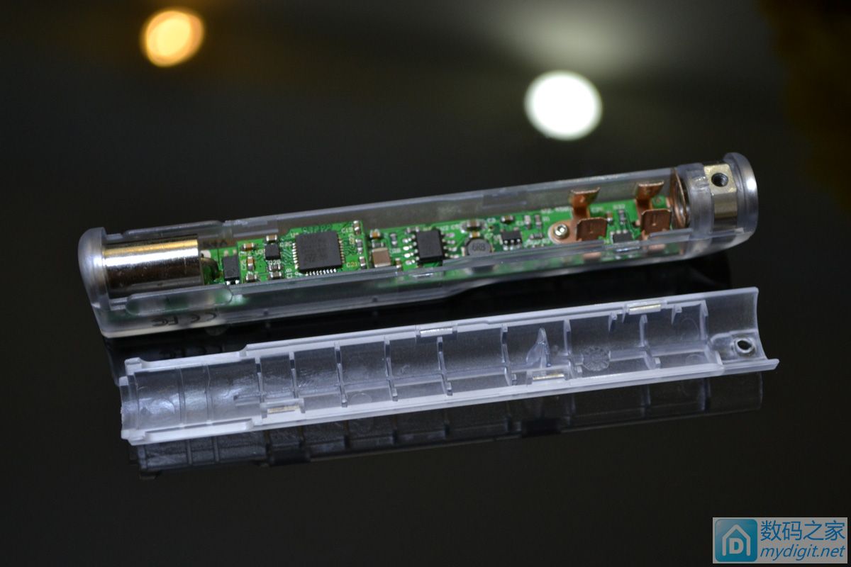

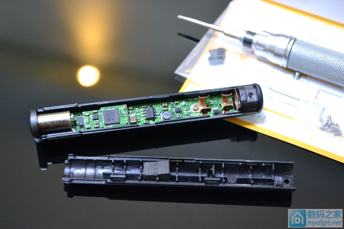

Open the back cover,then you can see the circuit

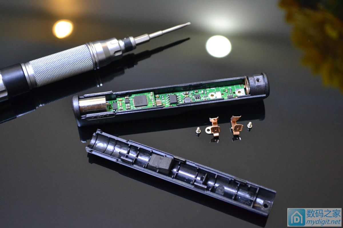

Remove the two pieces of copper spring clips that hold the iron core
Remove the circuit board

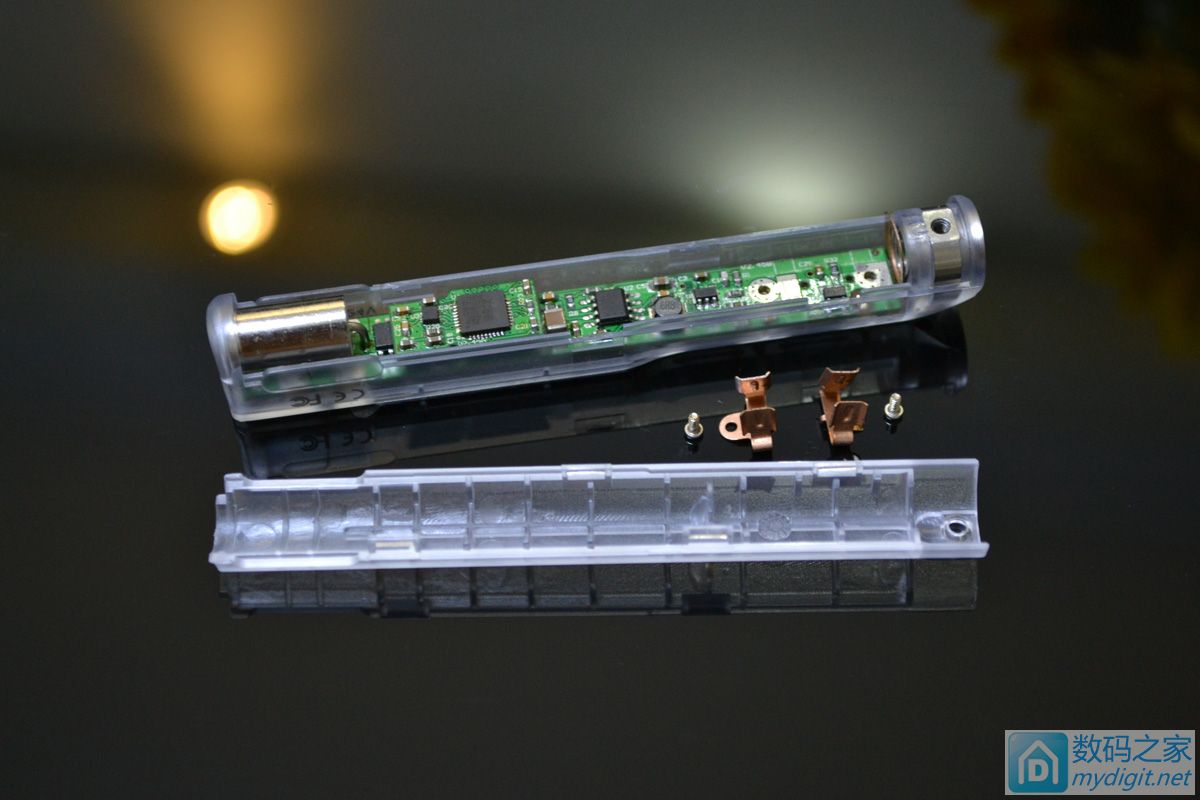

First install the grounding copper spring clip to the front
Then install the circuit board into the shell
Install the two pieces of copper spring clips

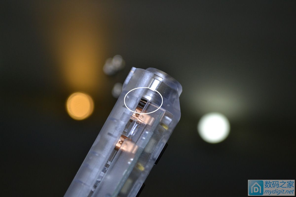

Pay attention to the grounding copper clip when installing back shell, press the grounding copper clip to the front, make it perfectly vertical before securing the back shell.

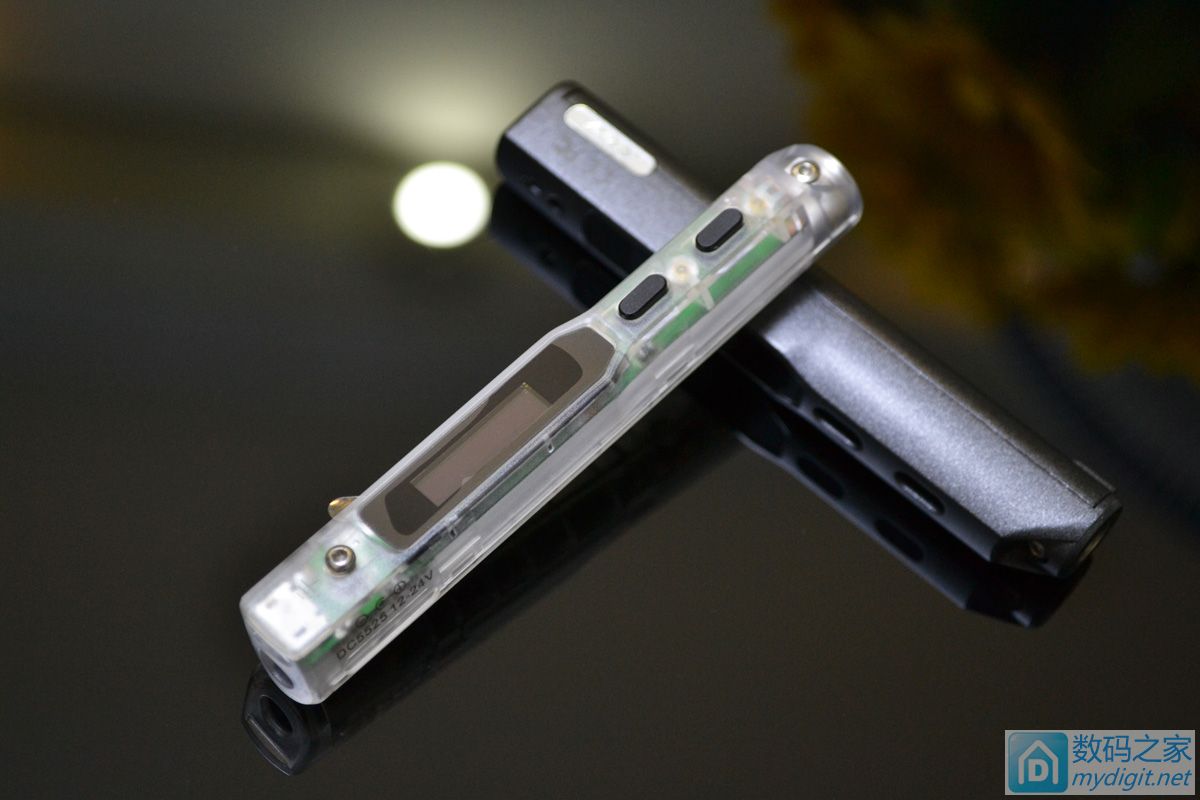

Mount all fixing screws in place

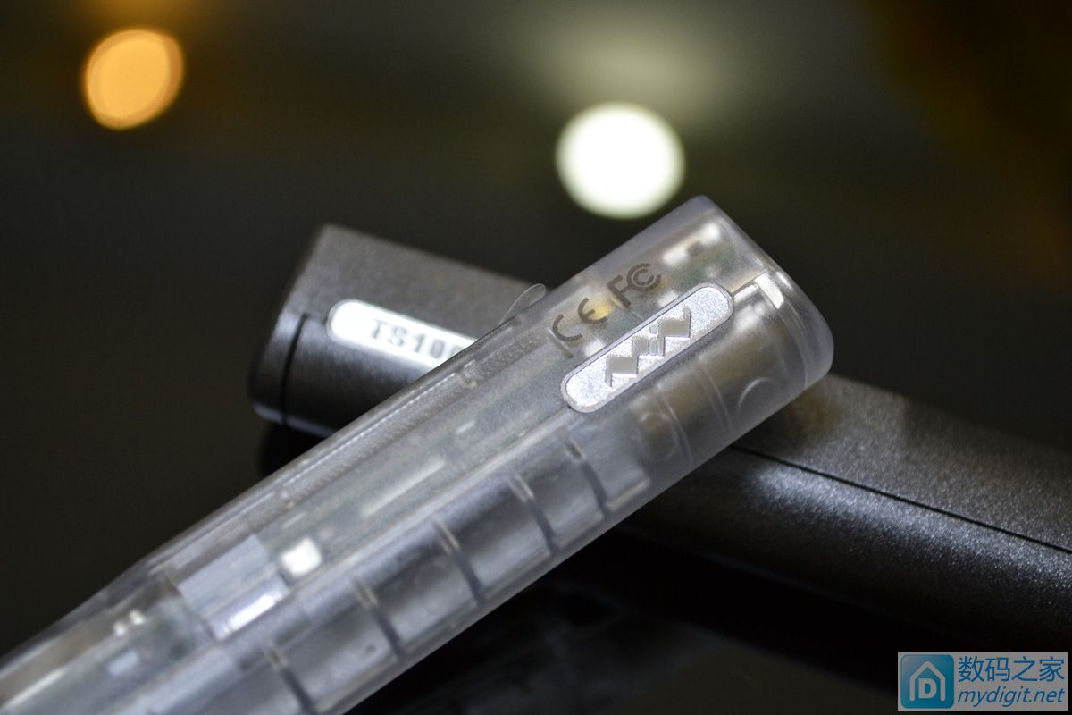

Finally, stick the nameplates to the shell on both sides to complete the installation
